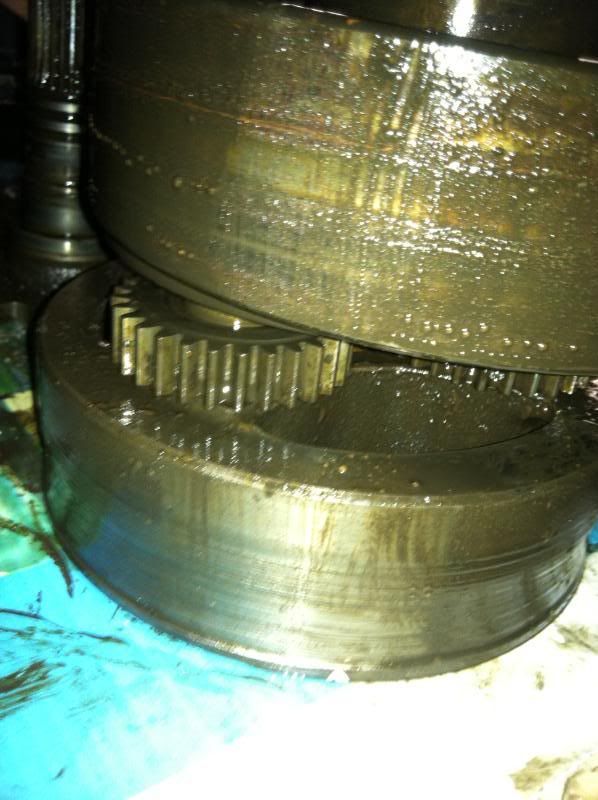

Well its been awhile since i've been on here but finally got around to tearing my dads t-20 apart on his 03 max iv. why tear it apart u ask...it wouldn't turn left (like zoolander
) so, i tore it apart and this is what i have

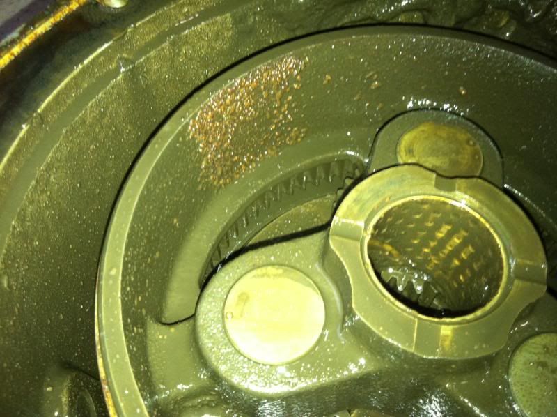

so...is all that gunk normal in there?? honestly it looked like anti-seize
is that little spring thingy normal in the seal?\

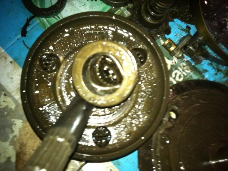

this is what it looked like right when i removed the halves.

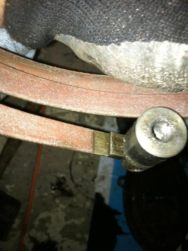

here is left side outer band
here is left side inner band....ouch!!

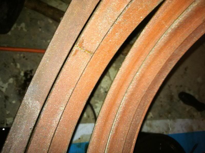

here is right side bands...looks like a crack in one...is that bad?

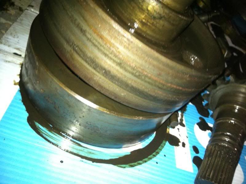

right side drums...def have wear marks in them...do i need to replace them?

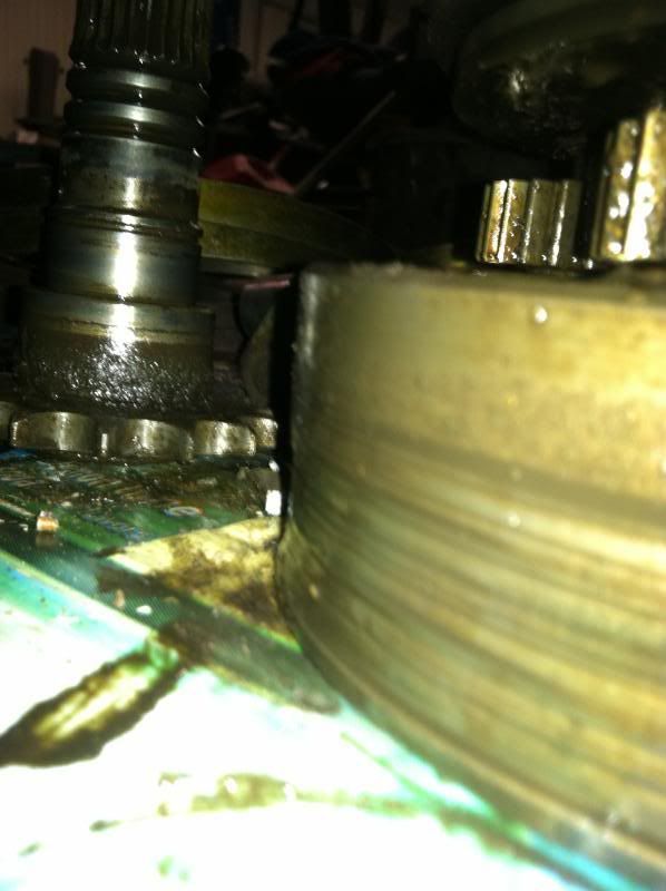

left side drums...and yes thats like an 1/8" wear mark!
so guys...honestly i don't know what to do...is it cheaper to rebuild this or buy a rebuilt one or any other options?? and the two outer bearings are really rough sounding so they probably need replaced too. thanks and i really appreciate all your help!
) so, i tore it apart and this is what i haveso...is all that gunk normal in there?? honestly it looked like anti-seize
