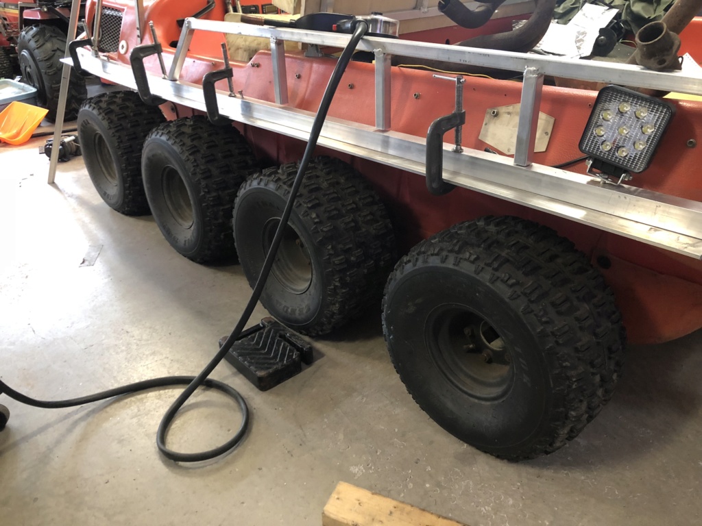

            When I picked up my aluminum order yesterday, I grabbed two 8 foot 3”x1/4” flat stock. This is for the body band lower piece. I was going to use 1/8” flat stock, but the argo tub has just a bit too much sag and I wanted the metal to help support it. 1/8” was just too flexible. I also bumped it up to 3” from 2” to give me a little bit of a “splash guard”:
            It also give me a place to attach wider “mud flaps” in the future. Since this is intended for search and rescue as well as a play toy, splattering mud and water all over the occupants isn’t really the greatest idea. So mud flaps will be needed.

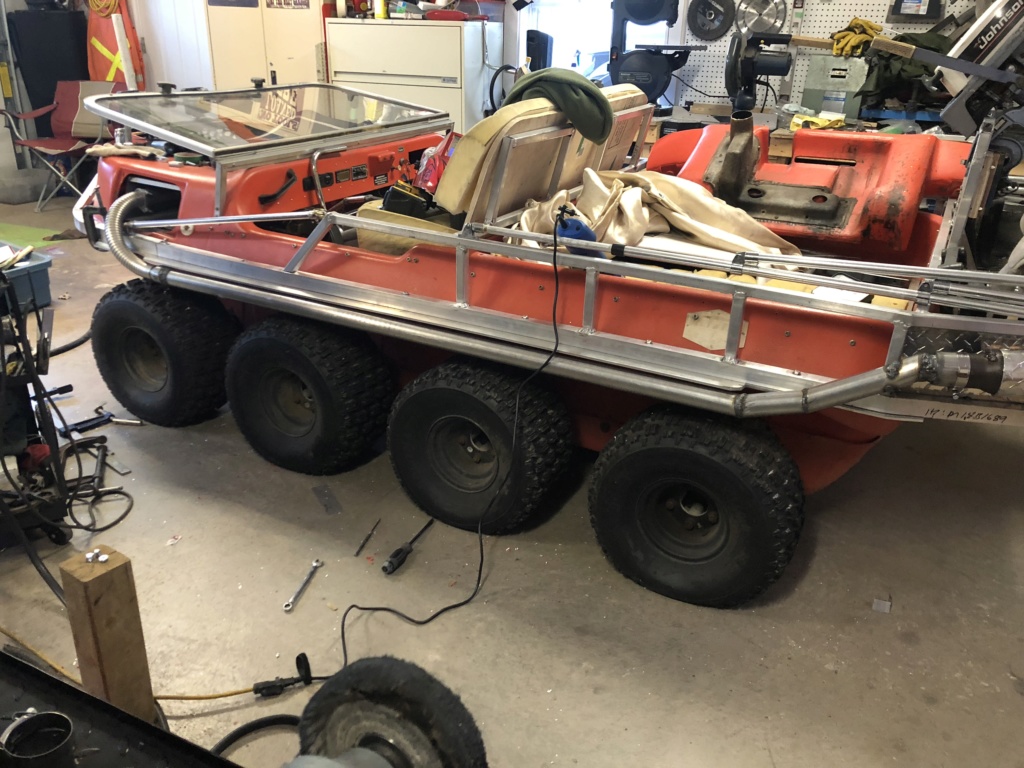

            Now orginally, I was thinking to run the exhaust pipe down the side to the rear on top of the “splash guard” to the rear muffler. But looking at it now, I’m thinking I might run it under.
            It’s a little more work, but the pipe would be mostly covered, which would be a plus for not accidentally getting burnt by the hot pipe when getting in and out and it would look a little less “ugly” when the pipe eventually rusts. I would do the header and pipe in stainless, but I’m not set up to weld stainless, nor do I have any practice at it. I might redo it later on when I get a bit better at it, but for now aluminized steel will do.
            It would be a little closer to the wheels mounted underneath, but since there is no suspension hitting the pipe is not an issue. When I do get around to building the suspension, I can just build it so the travel doesn’t reach the pipe.
            Thoughts?

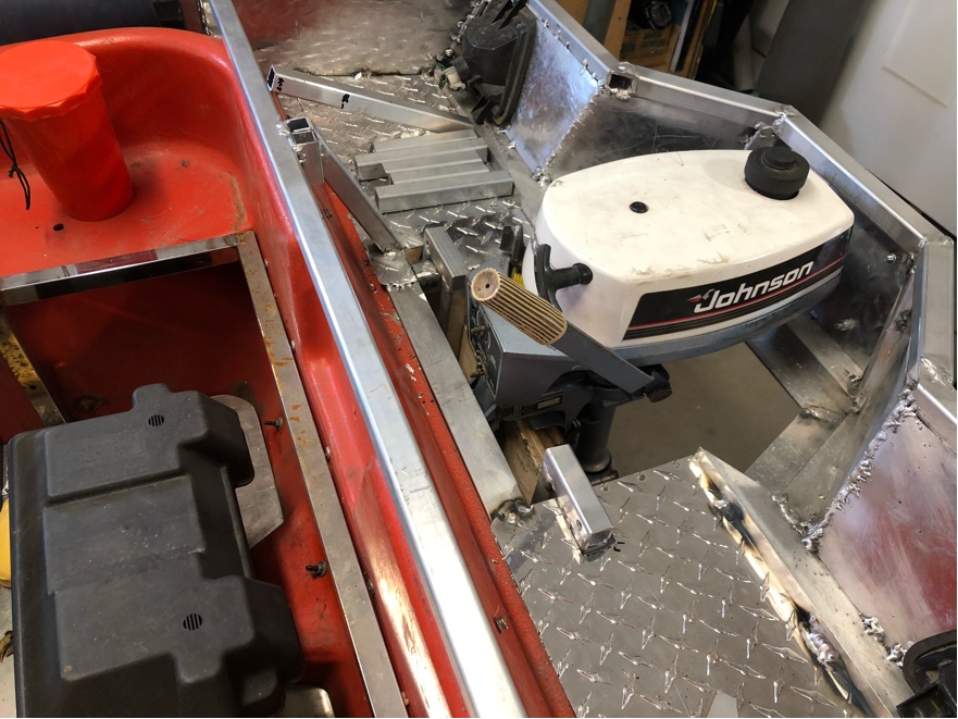

                  Finished up the fab on the outboard mount:
                  The small receiver on the rear rail will get a little padding to protect the leg and a strap or clip to hold the outboad firmly in place so it doesn’t bang around during land travel. It’s pretty solid and supported the way it is, a strap will keep it all from even twitching on the worst terrain.
                  The front just uses a couple lynch pins to hold it in place:
                  Pull them out and you just drop the mount legs down the holes in the deck:
                  You can see the supports and the square tube that the legs slide into underneath. The tubes are set at a 5 degree forward tilt, since the argo floats nose down. The tilt will just make it a little easier to get the outboard vertical once in the “down” postion. The outboard is angled back a large amount in this pic to clear the floor:
                  So when in the water it hangs down lower to get to the “clean” water just below the hull bottom. A side bonus of it being able to swing back so far (it can swing back even further) is if it hits a rock (or something soild) it will hopefully just pivot back instead of breaking off the skeg or prop. I still have to build a “rock basket” for the outboard lower for additional protection, but thats for another day.

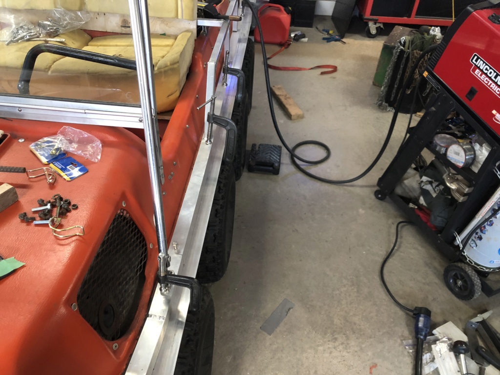

                  Now I think I’m going to take a break from the aluminum work. It all still has to come off and be finish welded, but its at least fabricated and strong enough for some light “wheeling”.
                  So, time to take the spool gun off and go back to the wire feed gun to do some work building the exhaust and then get it running again.
                  Coming along nicely.

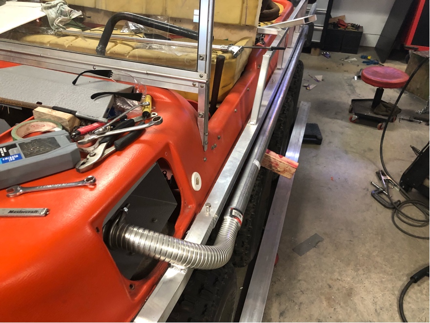

                    Building the exhaust:
                    I just went with the "cut and weld" method of forming the pipes. I don't have a bender and the "heat and bend" method I find to just be a major PITA. Besides, I had to weld up the collector anyways, so might as well just weld the bends up. Looks a little ugly, but some grinding and a spritz of header paint will fix that up well enough. I tried to keep the header primary tubes equal length, but there was just no way to do it without getting into more bends and turns. Even so, the rear primary is only about 1.5-2" shorter than the front primary. I'll just have to live with it like that, as if it's going to make a huge difference on an flathead Kohler 18HP opposed twin that was designed in the early 70's.....
                    The flex pipe might seem like a short cut or cheap way out, but it's there intentionally. Because it will move, it will help to absorb the engine vibrations and compensate for thermal expansion.
                    To make it all removable, the muffler will get springs to hold the slip fit joint together and the flex pipe has a slip fit piece of pipe as a transition between the flex pipe and header collector, which will also b held together with springs. The springs will allow for some additional movement for engine vibes and thermal expansion, as well as allowing the exhaust to be removed and re-installed reasonably easily.

                      But I resisted that urge and finished up the exhaust to the rear muffler. Quick sound clip of the old Magnum put-putting through the muffler:
                      Theres a few leaks I have to sort out, mostly around the diamond plate on the muffler. A little exhaust grade silicone sealant will seal that up nicely.
                      Yes, the pipe gets hot, but the 1/4 aluminum plate is going to cover most of it so it’s not a big concern. By the time it gets to the up pile for the muffler, it’s just “warm”. You can put your bare hand on it and while you don’t want to leave it there long, it doesn’t burn you.
