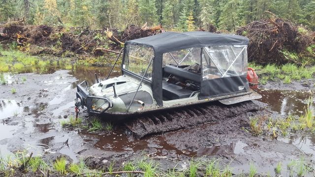

            I don't understand the fuss about counter rotation? Both units I owned counter rotated but to the point it would be pointless to even mention it?
            What do you mean there is a limit to the torque the admiral provides? I've been in some nasty stuff and never had an issue turning either side of my tracks in High or Low range. Maybe it's due to the High Torque trans I am running but I also had about 100HRS on the current machine with a Regular geared 6.4 trans as well...
            • #21
              Its still a differential. Lets say you fully jammed one side you will find that applying throttle will only allow one side to spin unless you applied steering. It does apply torque to both sides but it has a limit to how much force it will apply. It is not fully locked. The pic you provide is certainly a muddy situation but stick one side against a stump or embankment and it will stop driving one side. Dont get me wrong i love the admiral transmission I had the classic for 17 years so I know the difference but to think the admiral is fully locked on both sides when going straight is not true.
              So if the counter rotation is useless then they should have made it where it wasnt. True counter rotation would be a benefit in certain situations.
