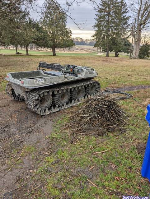

    Cup there is the reason I asked for all replies…… I never gave that a thought, we drive over the phrag one way but then we turn around and drive back over that path a little off of the original path. When going back over it, that is when it makes it stay flat because your almost snow plowing it. I need to run a bunch over and not turn back on it to see if the jam up is coming when your going back on it. I’ve got a feeling you are EXACTLY correct. The phrag is 14’ high.
    Gotta be honest with ya, this ones had me talking to myself lol. Been racking my brain trying to figure out how the phragmites is getting wedged like it is and that's the only conclusion I could come up with. I've done a little online research as well and every pic that had a vehicle in it was either a Marsh Master or an ARGO. Point is, you can't possibly be the only one having this problem. Hopefully my theory is correct and its shed some light on your problem....Cup
    • #32
      Delduck, in previous threads you mention the difficulty in cutting this stuff. Are you cutting it or simply running over it? I think Cup is right - driving into the top of the fallen plants is loading the tracks. Out of curiosity, did you drive the same with the Max machine? Can you run in the same direction (clockwise or counter clockwise) in your work area so that you aren't driving into the tops of the plant?
      I'm thinking like Cup - that the tracks may be picking up the plant and taking it along for the ride. Your pic shows the tracks have what I will call a serrated edge, leaving plenty of opportunity for a stalk to catch. I suggest you get a person to ride along beside you and watch what is actually happening. If the tracks are picking up the material, consider bolting a 4 inch rubber belt along the inner (and outer if necessary) edge of the tracks to protect the serration and keep it from catching or biting the plant. Also, consider whether turning is shoving a bunch of material into the tracks/wheels and creating the problem. Perhaps wide, sweeping turns will lessen the issue. I know its not efficient, but neither is the cleanout time you are experiencing!

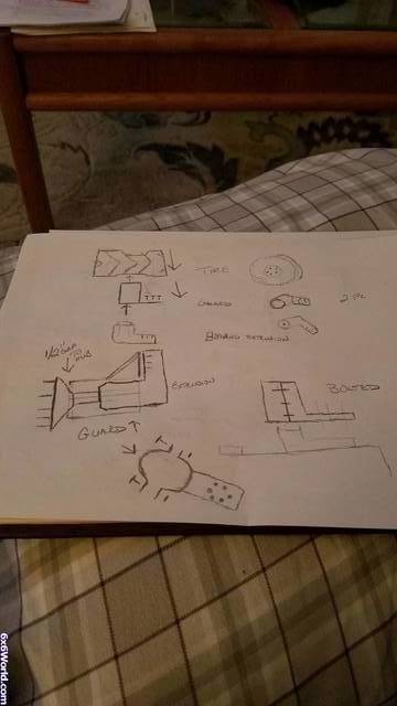

          • #35
            Guys I don't think the blade idea will be beneficial. Delduck said a sickle mower wouldn't even cut this stuff, so a blade with no velocity and nothing backing the vegetation isn't going to cut anything. Jim your idea of using a blade as a wiper of sorts. Delduck I'm going to draw up an illustration of an idea for a fixed axle cover. Stay tuned.

                • #38
                  I already did something like that dirtdobber if it shows up, its crude and would need to be 2 piece to be able to clean whatever makes it to the axle. They would only be good for front and rear, just an idea as I have had them in my head for a while but never materialized. Basically like a PTO shield to keep the debris from rotating part.

                            The grouser design may indeed be part of the problem but not all, using conveyer belting may indeed help with some of the problem.

                            • #44
                              Delducks picture.
                              • #45
                                Jim thanks for all the help. The belt idea is the easiest for me, my buddy has a tomato picker that gets new belts every couple of years, I’ll make that call tomorrow for the belt.
