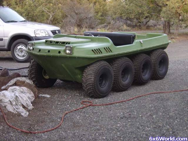

Im finally making some good headway on my argo! just finished replacing my inner and outer front bearings and all the ideler shaft bearings. Every piece of chain is new, every bolt I tuched is new with nylock nuts, every piece of wiring is new, new fuse block, homemade ground block, new head lights, new taillights, bilge pump, new seals in the transmission, new 3000lbs superwinch, homemade winch mount that ties to the frame, 850 cold cranking amp deep cycle marine battery, new seat, under seat storage and air horns
A big thanks to Robinhood02 fo giving me and yellowargo the idea of making a lift it works great!!! and makes working on the machine so much easer!!
Next on the list is to do the outer bearings on the back 4 axels before may 24 weekend for a argo ride. Hear is a video of my progress.
I tore out every piece of wire when i dissasembled the agro and made a new harness from scrach when i put it back together. I bought a universal trailer wireing kit to get a the diffrent colour wires , a bunch of push-pull switiches, and a fuse panel. I even made the hrarness to relocate the ignition switich and engine circuit breaker from the engine cover to the dash.
Im sure it would be easer to make your own harness that try to find a replacement for your argo.

welcome powerfist, you said that you had 3 bolt wheels. my guess is that you are late 60 to early 70. that said, my fiiance bought a 76 6x6 argo and it has 5 bolt wheels, with the left side drive levers. in here argo is a 11 horse honda. looks very similar to your 13 hp. and has no problems moving it around either. good luck with yours. we are doing a complete rebuild to hers, hoping to have all new running gear and back together before fall comes. we have stripped the frame out and refinished it, just need to get the tub all sealed before putting everything back together.

nice looking machine you got there powerfistargo.great to see a young man apply himself to a rather difficult project.most young people dont have your mechanical smarts anymore.
