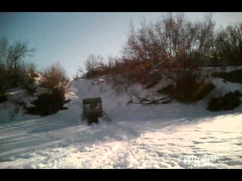

It sounds good. I look forward to seeing some video of it running. Tell us some more information about the swap. What kind of HP does that motor have, how much does it weigh, what modifications did you have to do, etc. Also, how does it perform now and what kind of speeds and RPM are you seeing?
Hi Mike,
I intend to get some more video today. I didn't install the engine, I bought it like that. I think that engine has about 60 to 65 hp and I don't think it weighs much more than the Kawi. The reason I say that is cause it floats up in the water as good as the Kawi. I haven't done anything other than add another fan to the right side to cool it down. If it's cold outside I don't turn that fan on. I get enough heat off the engine to keep the cab warm. It has lots of power. Speeds on tires up to 40 mph.
I don't know what the rpm is. I don't let many drive it cause you could blow the engine or a clutch and cause some major injuries and damage.
I haven't had any drive train troubles as of now. I do have some methods of my own for service as I've explained in previous posts. I also added a 1000 gal/hr bildge pump, and I found I was still getting water up on the belt causing it to slip. I added a little pump that pumps about 1 gal/minite and cleans it right out. I did put two new argo 22X9X8 tires on the front and now when I open it up in the water it'll lift the front end up about 6 inches. I don't get stuck unless it's really bad terrain.It would be interesting to have all new argo tires on and give it a run.
Anyway. it's lots of fun.

Wow, thanks for the videos Slim! Awesome machine!

. Looks like fun.
