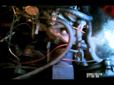

My m18 kohler starter packed it in just when I wanted the Argo to be up and running. It was just as easy to pull the engine to get at the starter than to stand on my head to get the starter off. While the engine was out I thinks to myself, it's getting hard to start,smokes a bit, maybe I'll pull the heads and have a little boo. SO, now I'm into rebuild mode when I came across the Chevy engine swap and a light went off in my head. Is there any pics of the installation floating around? I am going to try and locate a Sprint in the nieghbourhood before I stick any money in the Kohler.

Slim, at least 2 people here in Montreal are SERIOUSLY looking into the same kind of project. one in an Argo Bigfoot and the other in a conquest. Whenever you can add detailed pictures, please add them as it's a VERY interesting swap for us.Originally posted by Slimpickin View PostYou'll have to wait till I get home. I'll try a video of the engine compartment to show the mounts.
Slim
