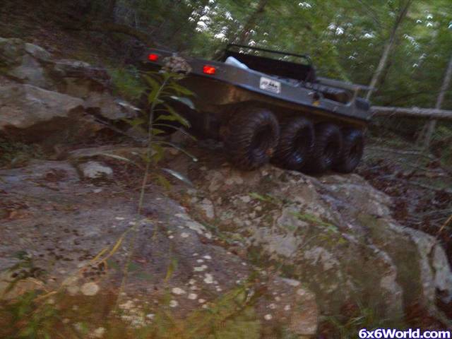

                    I'm still giddy over this thing. Went on a 4 hour ride last night with a buddy and another buddy with his wife and 3 year old son. I'm learning the best mix of feathering/gassing to provide a smooth ride for the youngins and ladies. I love this machine! Wish I could find some fellow 6x6/8x8'ers around here! (Reidsville, NC)
                    This picture on this rock do zero justice, it took several nail biting maneuvers and I'm nervous to inspect my skid plate afterwards! This rock is for you Rock.

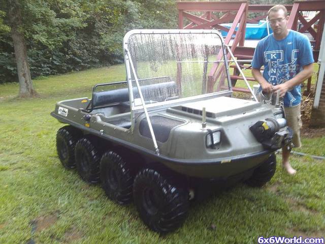

                    This is the first day I brought it home, if I were a magician I'd crop that hideous Wildcat shirt out of my Argo photo.

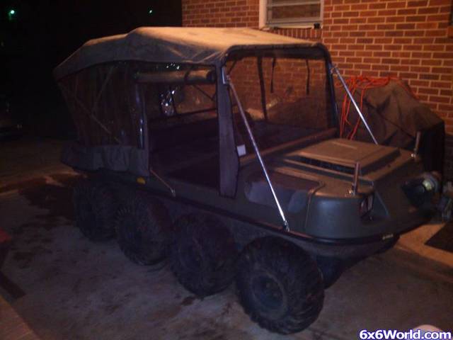

                    And my storm Argo, looking like a military vehicle.
