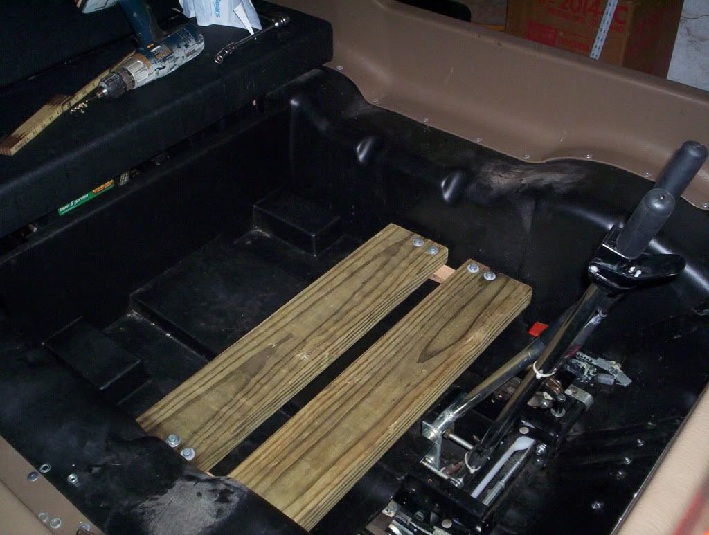

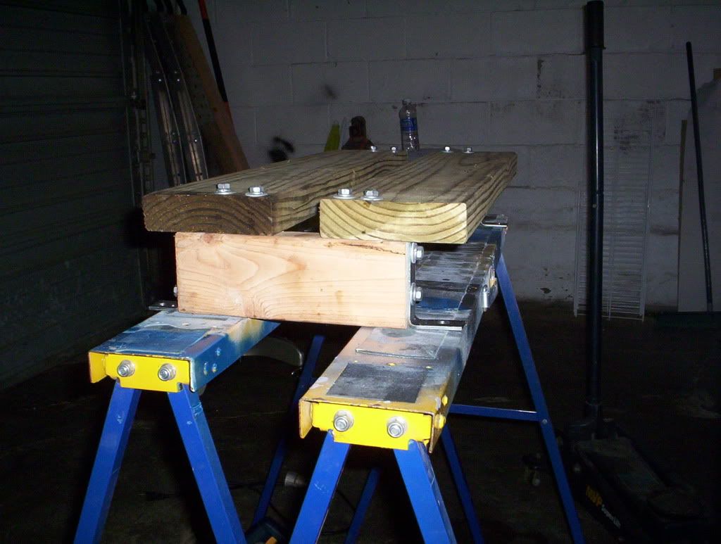

Here is the mount I built. It's just two 2x6's cut to fit the width of the tub and two 2x4's to set on the frame rails, along with some l brackets to bolt it down. It makes for a seat height almost exactly the same as stock.
Here is it set in place....

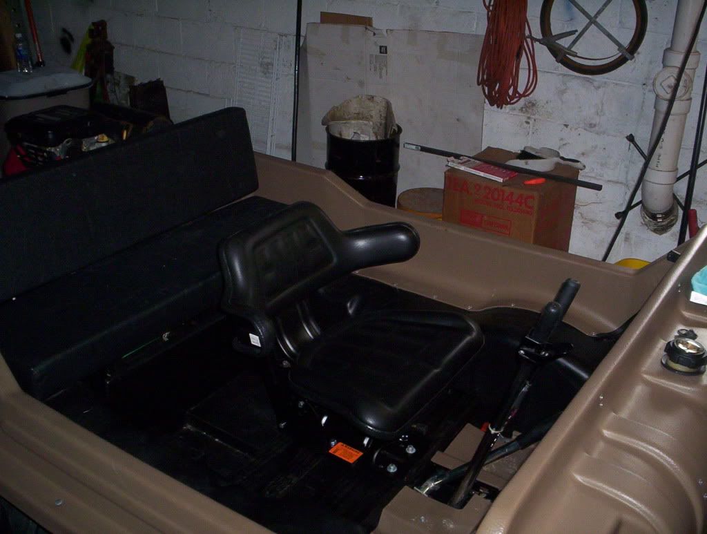

and with the seat in place.

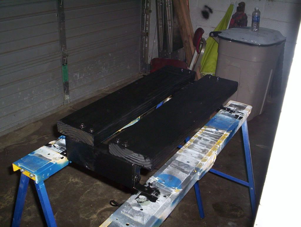

I painted it black to match the floor

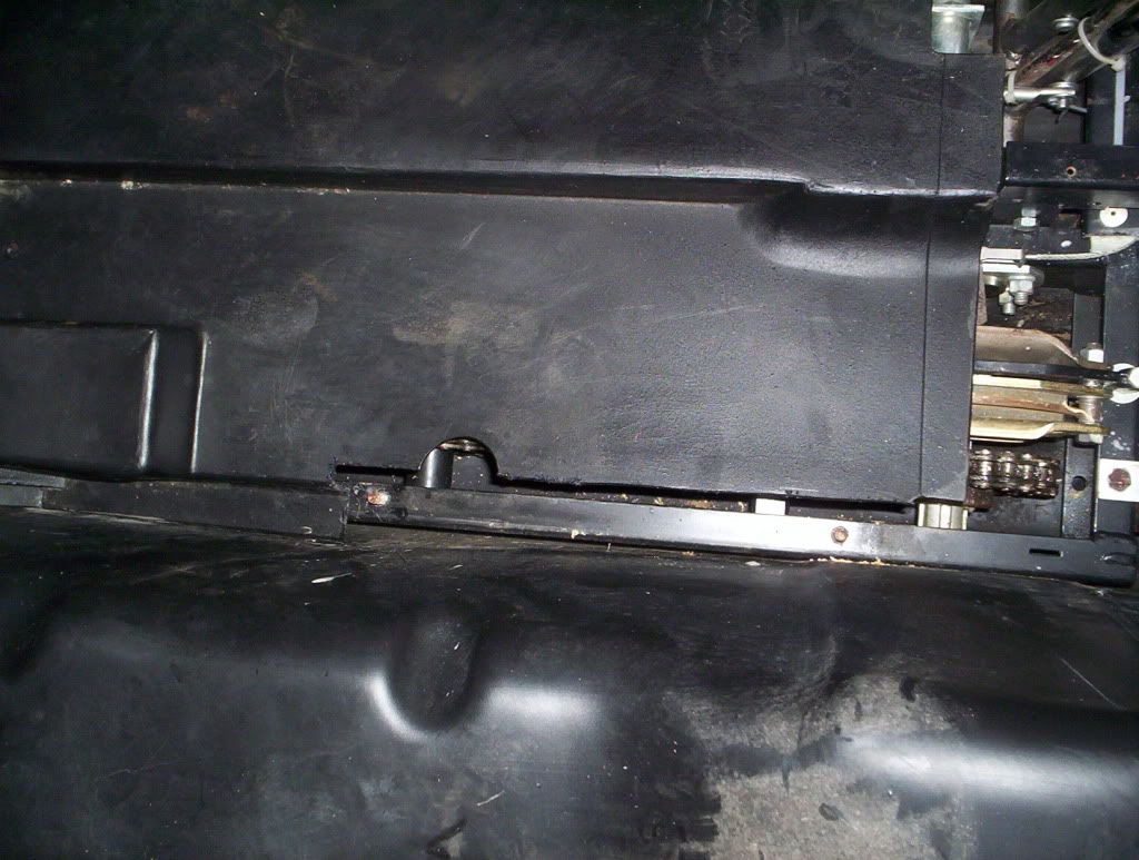

This is all the trimming of the floor that is necessary. I was happy about that just in case I ever want to switch it back.

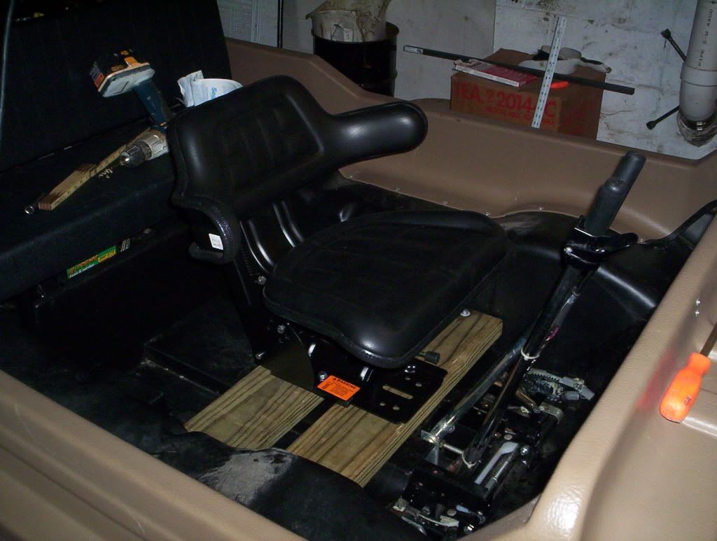

Last, here is the end result!
The only disadvantage I can see it that you can't pull up the floor without removing the seat. The one thing I will probably still do is trim the corners of the 2x6's to allow removal of the hold down nuts without using a swivel.
