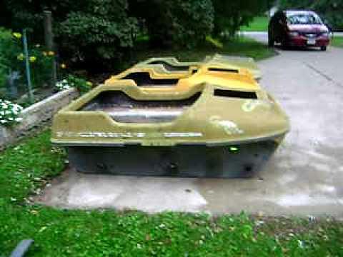

This will be my one single thread where I post progress pics of the restorations I plan to do on this trio of Terra Tigers. So far, I have them ripped down to their shell and just need to pop the tops off of them. I am hoping to get the fiberglass work done in the next couple of weeks and maybe get them painted before old man winter strikes Milwaukee.
Here is a video link and pictures. From left to right they are a TT 18 (#plate missing), TT 10 (hard to read number plate but maybe #1623) and a TT10 (#3163).
Each will be equipped with the frame reinforcements that came in the TT 18 and all the internal wood will be replaced. I am leaning toward keyed shafts all the way around with 5 bolt rims. I may try different engines (each with electric start)in each including at least one conversion to a 4 stroke (I have a good 16 horse Briggs sitting here with no home)
All internal parts will get soaked in an electrolysis tank (instructions in the video below in case anyone is interested) to derust, then coated with rust converter, primed and painted.
Tips and suggestions welcome at anytime.
