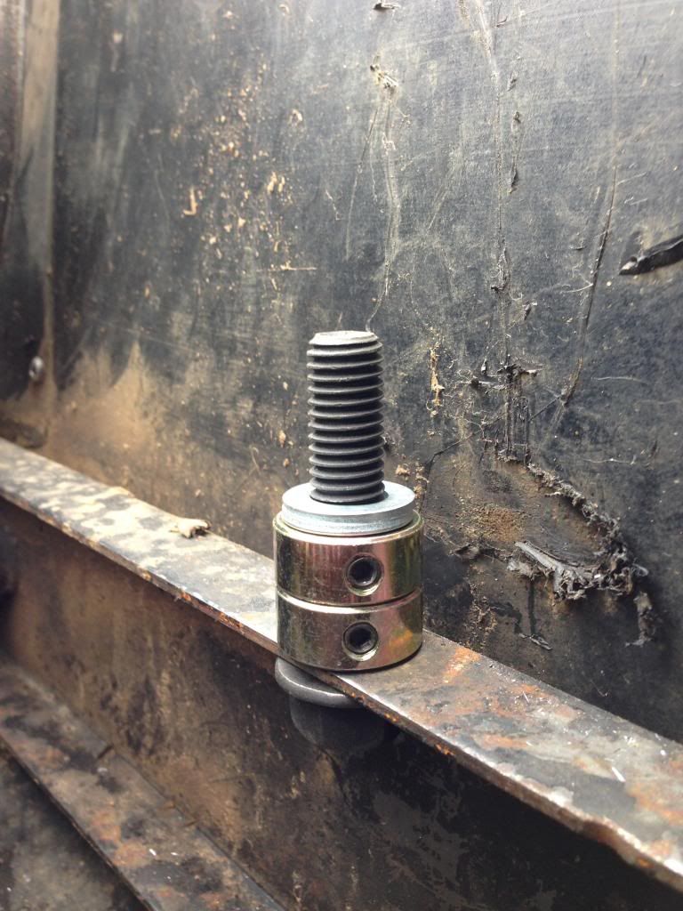

    I know this is an antique thread but I liked the idea of a solid mount to keep things from twisting during rev. Heres my townied up version. The bolt is Grade 8
    http://i1374.photobucket.com/albums/...ps06c003eb.jpg

        go to the GOLIATH thread and you will see what i did when remounting the bigger engine, if i can find other pics i will post them
        • #19
          heres some pics of what i did on GOLIATH without making the flex of the engine too rigid
          you want to have some kind of isolation but strong and stable.
