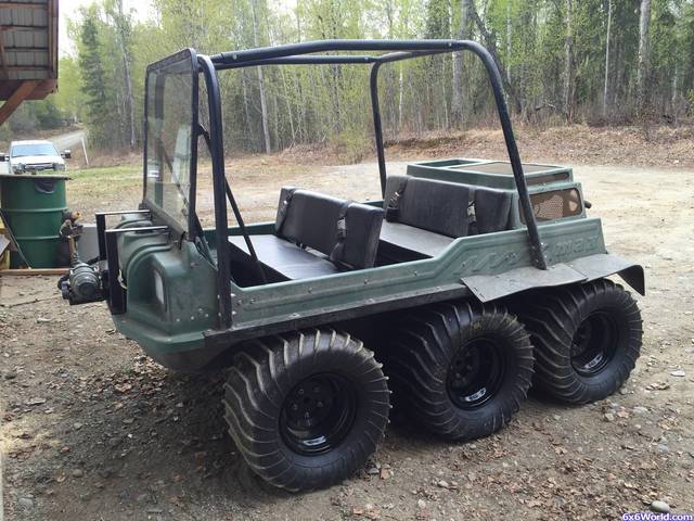

                • I got some of the 26x16x12's last week. The local MuddOx Distributor only had 4 in stock. I couldn't make myself wait so I put them on the corners and took it out for a little test drive. I'm liking them so far...
                  • I think I would have done the same thing. I hope your two others show up soon. They look great.

                      • That's what I thought. Those old wheels/tires always seemed a little under-sized, but I never thought of them as tiny until I saw them next to the new ones. I am fired up about trying to run the swamps on tires, instead of tracks, this summer.
                        • I finally got the other two installed. I am looking forward to getting out and shaking them down in early June. I would have gone around the house, but ran out of time! Life has a way of getting in the way sometimes.

                            • Originally posted by akcrawler View Post
                              Those Vendettas really make a Max4 look good, I must admit there is a set coming to me in the immediate future.
