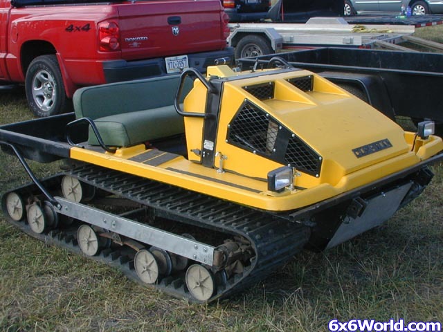

        Side view of the tracks They must be using a skid steer on this [IMG][/IMG]
        How was the trickster in the snow I have not followed them much.
