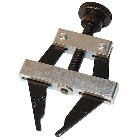

                  It's been handy...
                  • #39
                    Originally posted by glen1971 View Post
                    That's the one I use. I got it at the same time I got my chain breaker on Amazon. They were both worth much more than I paid for them!!!!! They were also in my tool box this year on the trail. Thankfully they stayed there!

                              Or they make an actual tool called a chain puller that works very well...
