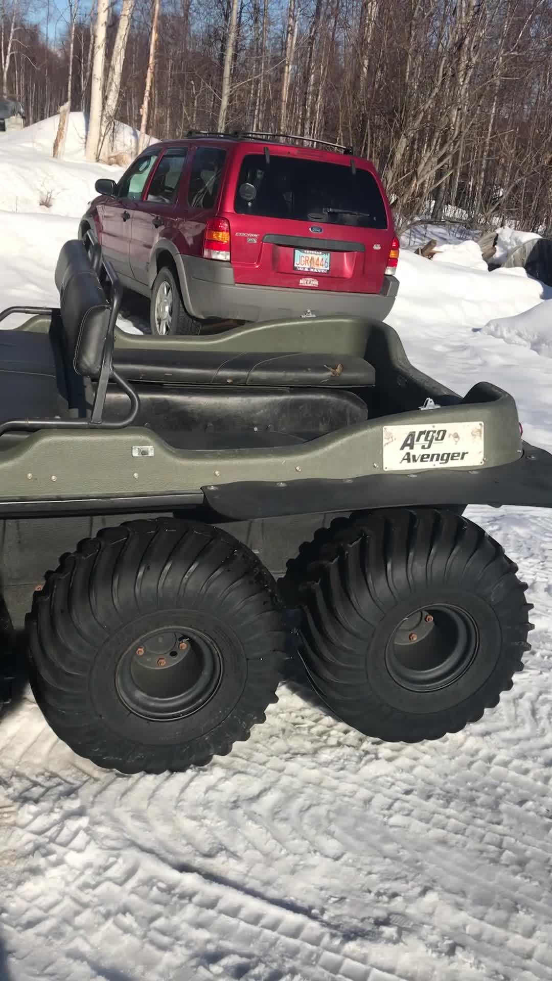

I bought this in the lower 48, it will need some repairs. What are somethings to look at on these? It has the automatic oilers, 30 hp engine, heater, tracks....
Just bought a used 2018 Avenger 8X8

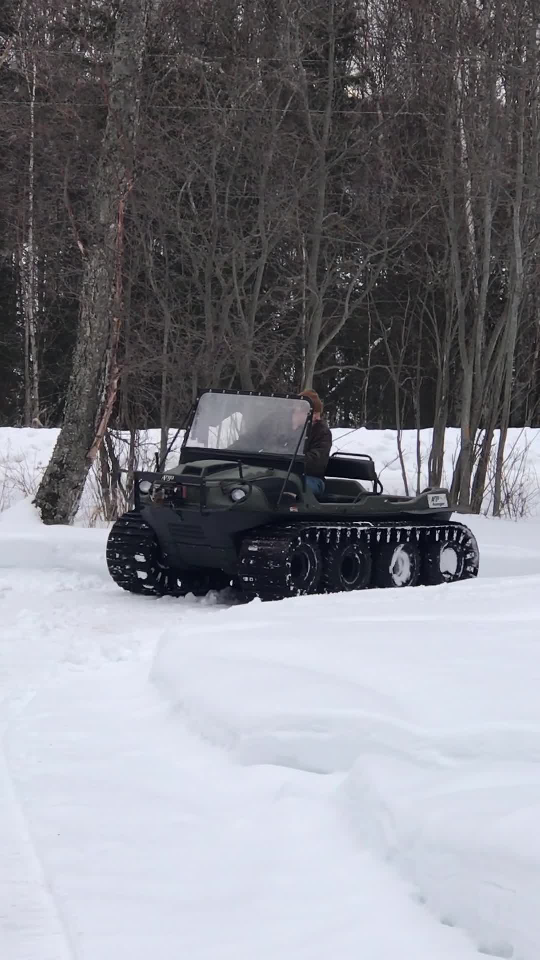

Thanks Dan and Noel! I am not sure which tracks I have, I think they are plastic.
Seems I have to upload pics to a somewhere else on the net, then post the links here. I spent 20 or more minutes trying to up load them, but couldn't.. even tried to copy and paste, but no!
Ya those are Argo rubber Tracks, call Buzz he will square you away on installation, depending on what you are going to do with them you might want to consider another type of track. Buzz is an expert in tracks and track types, let him square you away on what you need and what will work best for you.
