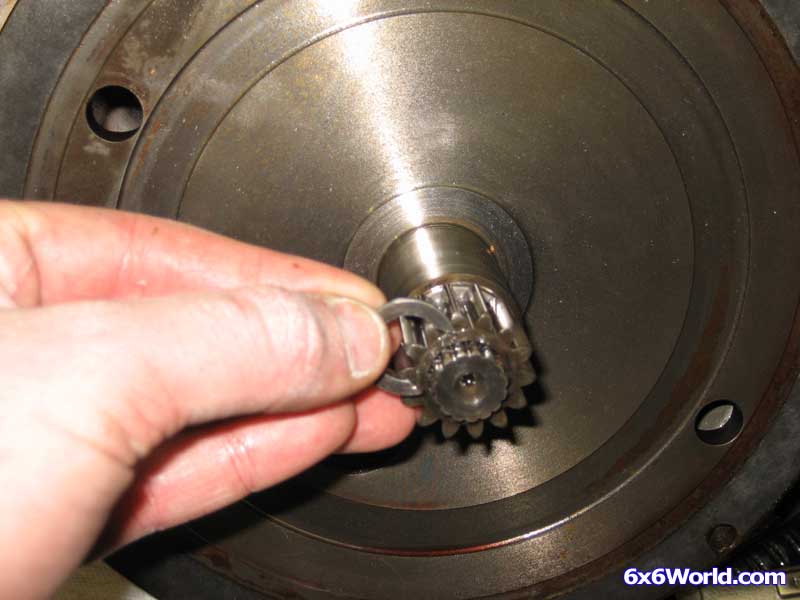

I got the halfs apart but it's like the plate won't come apart. They are about 1/2 inch apart and won't come anymore. Something is holding them together. Very aggravating..

After you split the cases and get the right-side off of the center plate, you'll have to take this C-clip off in order to get the center plate out.
If all of the bolts that hold the two case halves together have been removed, there's nothing but friction (and maybe some silicone if it's been applied) holding the halves together. Honest.sigpic
Soon. I got the t20 apart, I made 4 jacking bolts and pushed the plate out (way too much permatext) the end of the plate that is in middle of trans is messed up I think I put washer on wrong end. Also I think I need new bands and my drums turned. You can see all pics in my album(90s max 2) What would you do? Thanx. Norm...
