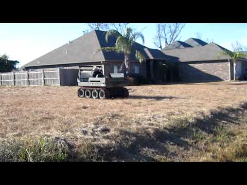

                            • KID 8X8 New Track Cleats!
                              LTV Kid,
                              I finally got my track upgrades done. I finished before duck season but couln't get it trailored with all the other stuff I had to take from New Orleans to Monroe. I did take my Hoot 6X6 and it did great in the flooded woods carrying 2 of us and breaking thru the ice at 25 degress... COOOLD! Wish I had the Kid. Next year will be different I just got a larger trailer. I upgraded a car hauler and made it where I can load from all sides and carry the Kid, the Hoot and another.
                              More about the track upgrades. I got the idea from the Adair tracks and used UHMW which s a low friction plastic cut into 1X 1 and a 1/4 then machined rounded edges, counter drilled and bolted them to the tracks. Lets see 90 holes drilled per side, 90 bolt sets, new bolts at every track break, minimal weight gain and nooowwwww I can spin on concrete like someone greased the concrete. I had to go back to the 8.50 tires to use the tracks, 10.50s won't work but I have enough clearance between the track cleats and the fenders and gained about another inch of ground clearance! About $5-600 in parts and TIME!
                              Haven't done much testing yet, but I fully expect more speed in water, more grab in mud and a lot less stress on the track rubbers. In other words the best Kid upgrade I can think of. I only have 1 video and it's rough but you can get the idea. I finished the trailer rebuild and hope for a sunny weekend this weekend to load everything and get my tie downs properly placed so I'll get some video then.
                              Kid track cleat video:
                              Sorry, here's the Hoot video!
                              Southern Comfort Kid
